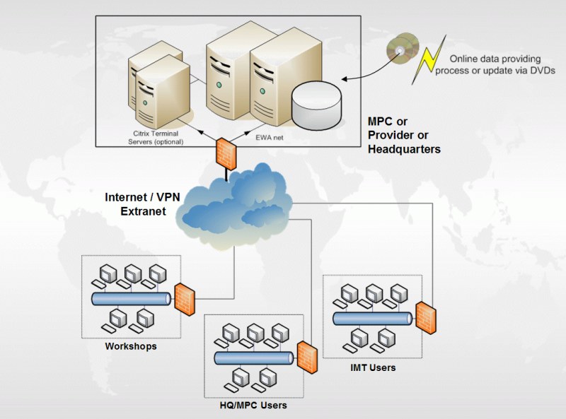

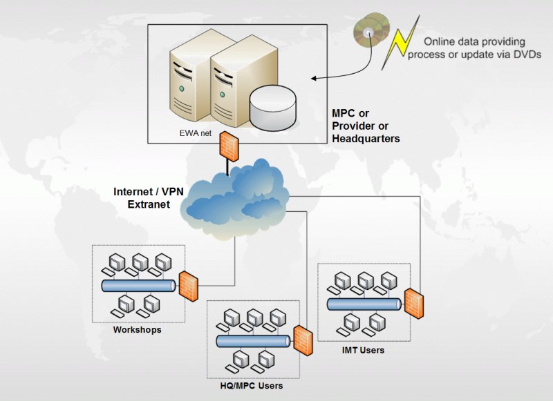

1.4 Central Operation Scenario the recommended Solution
- A central server environment is installed at the MPC, at an internal or external ASP, or at Daimler Headquarters.
- All user types (workshops, internal users from Daimler Headquarters or the MPC, and even independent workshops - IMT) may be connected to the central server via
- public Internet
- VPN
- Intranet
- Extranet
- The central server will be updated with DVD delivered by Daimler or using the online data providing process.
![](res/operation_szenarios_01.jpg)
1.5 Central Operation Scenario with Citrix
- All installations can be combined with Citrix: terminal servers are set in front of the EWA application server.
- This setup is particularly beneficial with the central operation scenario.
- Citrix users connect to the terminal servers, which in turn query the application server. In parallel, other users may connect directly to the application server.
![](res/operation_szenarios_02.jpg)

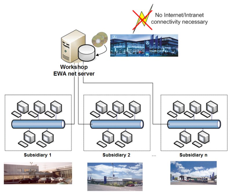

1.6 Local Installation: EWA for one Workshop (incl. Subsidiaries)
- If no central solution can be established, e.g. because no Internet or Intranet connection is available in a particular workshop, a local installation may be set up.
- The (main) workshop, or all subsidiaries of a business are connected to a local server installation of EWA.
![](res/operation_szenarios_03.jpg)
